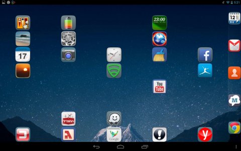

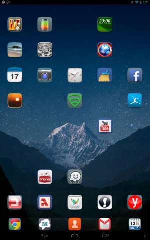

I've installed the 4.3 update on my nexus 10 device and I noticed two weird things:
1- The navigation soft buttons are now apart of each others more than 4.2 was (it may be new change in 4.3).
2- These buttons disappear when I use the tablet in portrait mode which is very odd. (check the attached images).
Any one noticed this issue ????!!!!

I am seeing the same issue on my nexus 10. Bottom navigation ribbon is gone in portrait mode.
I did download 4.3 as suggested by the system update. Update went well and post a reboot this strange thing happened.
It is a serious bug on the tablet. Did try to switch languages (I am using Hebrew as default), but the same phenomena is seen when I change the interface to English.
This is very bad, as there is no way to go back or jump to home when an application runs in portrait mode.
Google!!! Help!!!
I'm having the same problem.
The soft keys disappeared in my nexus10 after update to android 4.3.
Hard reset helps until you restart your device once again.
The nexus 10 is useless without the soft keys :-(
Does anyone have a solution?
Or
Can you tell me how to downgrade to previous android version?
Thanks!
I had the same problem and (I think... ) I had solved it:
It seems to be that the problem is when you install/update android 4.3 in Hebrew/Arabic.
I did a factory reset and reinstated android 4.3 in English (US). It seems OK even after I turned off and on the nexus 10 several times.
I'm afraid to try to change the language to Hebrew now because it might install new files that well make the same problem. If one of you will find a way to use it in Hebrew/Arabic without any soft key problem, I'll be happy to hear.
Shalom, Peace from Israel to all our Arabic users friends, where ever they are.
I posted the issue on Google issue tracker, and for a workaround you can choose the language Arabic/Hebrew then if you restarted the tablet and the navigation goes wrong , change the lang to English and restart every thing will be good again and change to your lang.
Just be sure not to restart with your lang set to Arabic/Hebrew ... Always restart on English till the issue is solved from Google.
