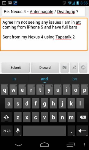

Agree I'm not seeing any issues I am in att coming from iPhone 5 and have full bars
