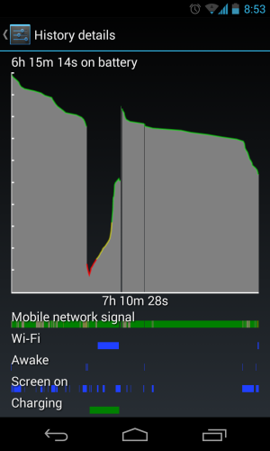

i have had my nexus 4 for 3 months after the 4.3 update it worked fine for 5 days now facing battery draining from 50% it goes blank then i need to plug in the charger to switch on the phone again
the phone goes from 0 to 100 % in real quick time
Yikes. Does it get really warm when the battery drops like that? Do you have a battery monitor app like GSAM installed, to see if you can narrow down what might be using up that battery?
from past 5 days same issue once it reaches 50% the phones get switched off i need to plug in charger to switch it on
i have restored my phone twice but no use
the battery doesn;t get warm at all

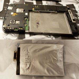

You could try to revert to 4.2.2... If it still persists then it would point to a faulty chip in the battery.
I guess It's because of a faulty battery. I've experienced the same until I replaced the battery by myself.
I had this with my nexus 4 about a month ago.... The battery had basically burst open inside the phone... I took it to car phone warehouse and they replaced the battery for free under warranty. Although I did have to pay 20 pounds to get them to di it that day rather than wait 2 weeks...

When mine had this problem entering the screen lock password I found.after typing the pin if you hold the enter button for a second or two before releasing it the screen unlocked correctly. Its only a matter of time before the phone will stop working completely ( see the photo above)
