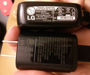

The charger that came with the Nexus 4 (bottom in the image) has the following specs:
Input: 100-240V - 50/60Hz 0.2A
Output: 5.0V - 1.2A
The LG STA-U12WR retail charger (top in the image) I bought has these specs:
Output: 5.1V - 0.7A
Will the difference in output cause any damage to the phone using this LG STA-U12WR charger?

Well it is recomended to use the charger that was provided in the box but you can use ajy other charger that will work for other micro usb phones.

Because the power output of the LG charger is so much lower (0.7 amps compared to 1.2 amps), charging your phone will take significantly longer...
Ok, thanks for the info. I wanted a spare for travelling and won't mind the extra time to charge (it'll be done overnight anyways).

Not sure about "the same", but the next time you go out looking for a charger, be sure to check the output current rating. Look for at least 1.2 amps; for a really fast charge, pay the extra bucks for one with 2.0 amp output.

I can't remember where I read this, but charging the phone with a 2 amp adapter consistently isn't good for long-term battery health. It's OK to do occasionally, but not everyday. Anything that provides 1 amp should be fine.
The original adapter that comes with the US LG Nexus 4 is a model LG MCS-01WR. It is impossible to find this on eBay and most OEM LG adapters are only 0.7A which causes slow charges. I did find this exact adapter from a Hong Kong source:
