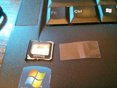

3rdeyer's instructions worked pretty well. I'd like to add some details.
First of all, I inserted the plastic strip UNDERNEATH (when the screen is facing up) the sim tray and just jammed it in as far as I could. I used only 1 strip and I have a photo here to show what the dimensions are. You don't need 3cm of length because it won't go in that far, but it's a matter of having something for your fingers to grab onto. So what I'm showing is probably more like 2cm. I made mine a little less wide than the SIM tray and it worked wonderfully.
One thing to note that as you jam the plastic strip in, it seems the SIM tray slides inward a little too. But do not fret! Once it won't go in further, start pulling out the SIM tray. Pull it out in conjunction with the plastic strip. You won't be able to pull it all the way out, but that's fine. It'll be mostly out where you see the nano SIM tray, and you can slide the nano SIM in. Once you slide it in, you can pull the entire TRAY out now. Finally.
