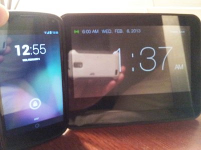

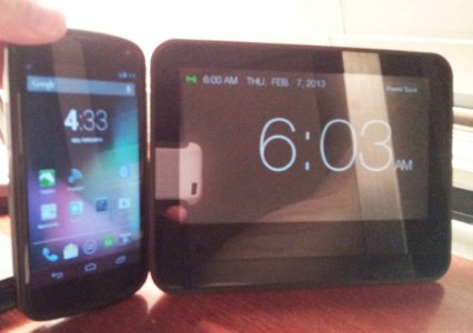

Early Morning.jpgLater Morning.jpgAll, I decided to take pictures of what is happening on my phone in with regards to the phone issue. The early morning picture was taken when the phone went into hibernation with wifi on. The later morning picture was taken after I turned the wifi off (at 1am) and it went to into hibernation. Something screwy is going on.
I do use Beautiful Widgets on the phone but can't see that causing the problem.
Any ideas? Thanks...
