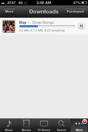

I wanted to point out how bad AT&T is in my area as compared to T-Mobile. I did a speedtest.net test on my Nexus 4 with a T-Mobile prepaid account and an AT&T iPhone 4S obviously with the simcard that it came with when I bought the phone at Radio Shack back in January. There is no APN to configure on the AT&T iPhone since it is locked to AT&T, the only carrier it is designed to run on. I get the same AT&T results when I use the AT&T sim in my Nexus 4 and configure the APN. I also get the same results using an AT&T data only sim in my Nexus 7. AT&T is just plain garbage in my area. They were rated the worst in speed and CS last year here in Colorado and the average speeds were about .5Mbps in that poll. As you see, things haven't gotten better. I also had a Verizon iPhone 4S that was just as bad as the current AT&T 4S that I have now. It was so bad, I broke my contract early and sold the iPhone back in January. I'm about to do the same with the AT&T 4S.

Yes, it really feels that slow and IS that slow. As I said, I got those same exact speeds on a AT&T data only sim in my Nexus 7. AT&T IS that slow in my area. Really, it IS That slow. The speedtest app can't be broken on a Nexus 4, Nexus 7 and every iPhone I have ever had.
I have pages that won't load and apps that won't work all the time giving the no network message. I know enough about phones and APN settings to know it's not those.
Over 9 minutes to download a 7MB song.
