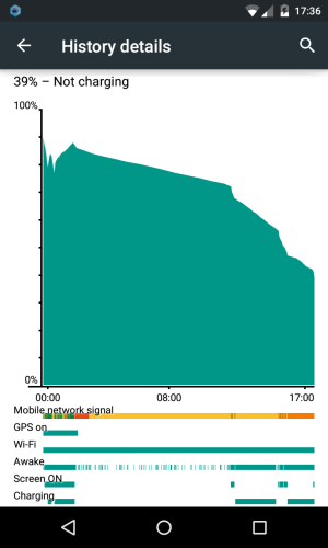

I've had a similar experience.
I haven't had a problem when connected to a wall charger, but connected to a PC it often (but not always!) won't charge. (Seems to be something related to having the data lines being present - I'll test out the PC with a dumb Chrome cast cable, it only has 2 connections).
Annoyingly, the icon on the status bar indicates it *is* charging, but the words of the battery details page says it isn't. So the only way to confirm, is to go into the full battery stat page.
How's this for a confused image?!
(Check the status bar icon, and then the words on the page and graph).
It's not a charge safety shut-down, the phone was totally cold.
Just for clarification, this is a Nexus 4 which never had an issue. The cable, PC etc are all unchanged. The only change is Lollipop (full wipe factory install).
