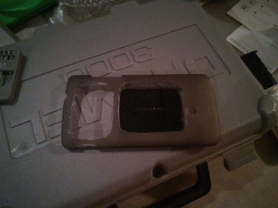

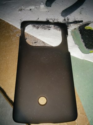

That's my case that I cut already

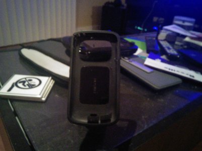

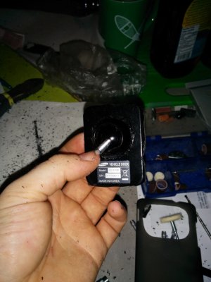

The gnex car dock that I have(using the non pogo pin version)

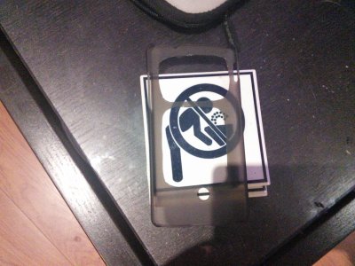

So I took apart the car dock, and just held the two cases together and traced the finger pusher out so I can easily get my phone out after. Also because I still want to be able to take apart the dock and add a NFC sticker in the back I cut out the samsung door, unfortunately I doubt my case will hold to the car dock case when I try to bond the two together due there not being enough structure in the middle. I will still try but I plan to get another N5 case and not cut out the Samsung door part.

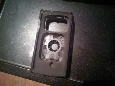

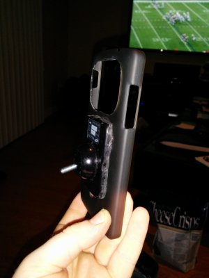

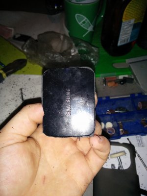

OK so I got a new case and I only cut out the finger bang to push my phone out easily.
Also cut out most the plastic of the gnex car dock and only left the Samsung door, because the gnex had a curve to it I needed to have a straight part of the dock which would have no gap.
I used epoxy to hold the n5 case and what's left of the gnex dock. Let it sit for a bit and it looks to be holding fine. I haven't tried to pop off the gnes Samsung door from the n5 case yet, but it should open up and allow me to put a NFC sticker inside.

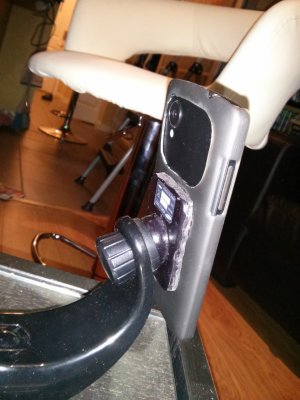

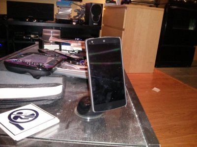

So I did finish my small project, as I thought I did have to buy a new n5 case, essentially I forgot that the gnex had a curve to it. Even with the amount I cut on the gnex car dock case, the n5 case and card dock case would not bond together due to a small gap.
I got a new case cut out the finger bang to push out the phone. Then I cut out everything on the car dock side so that the Samsung door would be the only part left. Picture will be uploaded but I can finally watch YouTube videos on my way home from work while I drive :)
