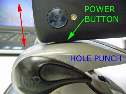

Same thing just happened to me. Nothing would interfere with the "Power Up / Power Down and Repeat" cycle. I thought the phone was bricked! I read on this forum about re-booting, etc, and the "tapping the power button" trick.
It worked! I gently tapped the power button on the phone on a firm surface (what quickly fell to hand was a hole punch device on my desk...) I used the phone a bit like a small hammer, and allowed the power button to fall onto the metal body of the hole punch.
Lo and behold, it's now powering up just like it should. :)
