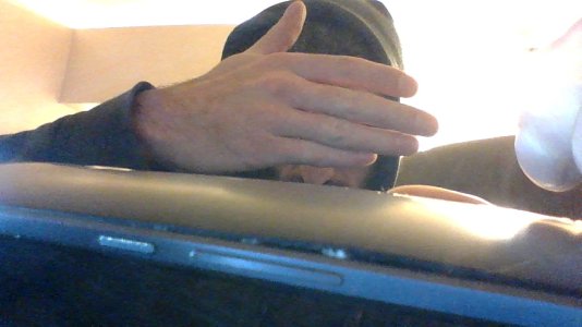

I agree with people that the teardown reveals that the glue is quite weak. That is such a glaring oversight on behalf of Motorola. Public perception is everything and Motorola finds a way to ruin it on account of $.12 dabs of glue? 1423185967729.1.jpg

I agree with people that the teardown reveals that the glue is quite weak. That is such a glaring oversight on behalf of Motorola. Public perception is everything and Motorola finds a way to ruin it on account of $.12 dabs of glue? View attachment 162085
I agree that it's a design failure and I don't think there's a simple way (like stronger glue) to make the cover stay put as if it had been designed properly. That said, I'm leaning toward getting one in spite of this.
This issue isn't a deal breaker for me. It's a fairly inexpensive fix if the worst does happen.
