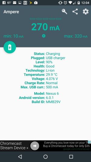

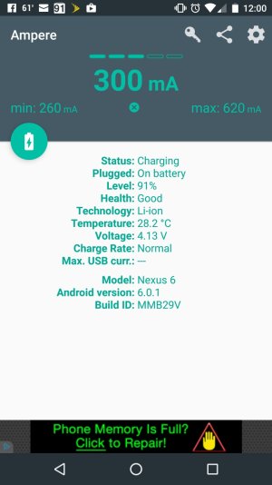

Here it is on the quick charger. Shows it is not charging in the indicator (and battery charge does not increase) but it shows that it is receiving 300Ma's from the charger. When the phone is off, the quick charger will charge the phone. So strange.
And here it is on the regular charger. Shows it is charging and it does charge.
Both show "Status: Charging" and it looks to be taking a charge, albeit slowly.
If you are over 85% or so, the charging will slow as you inch closer to 100%.
Run it down below 50% and see what the app shows.
