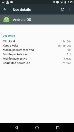

View attachment 227983I charged my phone last night to 100% and had everything turned off except data and Bluetooth. In just 6 hours, the battery dropped 14% without me touching it.
something keeps you phone awake.
please install GSam app and run it to see what keeps your phone awake.
and try to run it safe mode to seee if this make any change like mentioned above.
