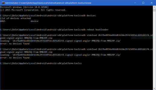

I ran it again. This time I ran "adb sideload" and it gave me the same error. So I unplugged/replugged the cable and ran it again. It worked! I'm now on MMB29Q! And guess what? The March update notification popped right up! Done!

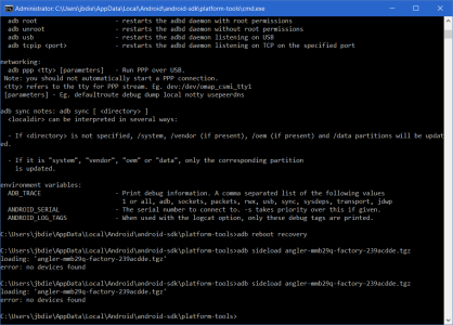

Definitely not difficult at all, there is a hiccup or 2 regarding getting the device into the recovery option and making sure that adb sees your device. But if you run into those problems I'll happily tell you what I did for both issues.
Hi,
Issue can be 2 things
1. your device driver is not properly installed
2. i had that before, enter the ADB with Administrator permission (right click > open as Administrator )
