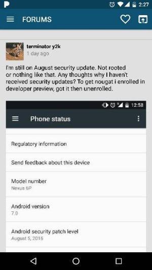

Did you unenroll from developer preview? I was contemplating signing up to get security updates but don't want phone to be wiped out. I signed up for developer preview to receive Nougat update bc I wasn't receiving it..
Picture didn't attach.. seems to be a glitch with app. Not uploading pictures. Wtf! !!
