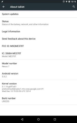

My stock 2012 nexus 7 WiFi got updated today. When I got home from work the notification was there to update. Better late than never I guess.
