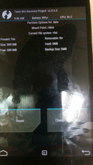

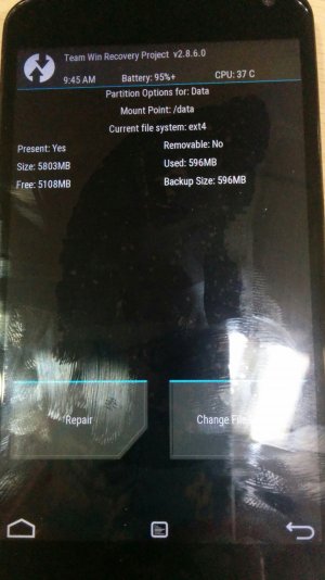

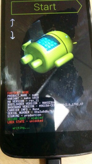

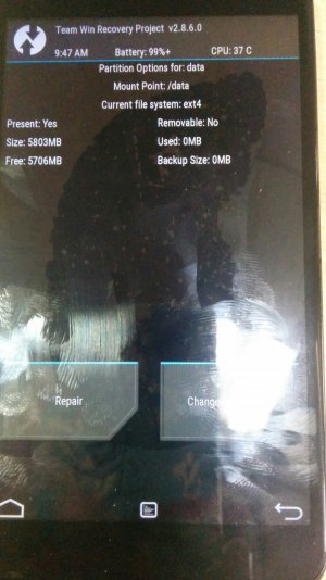

hi,
I have similary problem with my Nexus 4 16 Vairant.
on Bootloader screen it shows 16 GB variant, but when OS boots it shows 5.8 GB. Pic attached
I followed your guide of changing File system in TWRP but after changing file system it doesnt show 16 GB or near by it remains 5.8 GB.
I have attached 3 pics here -
1 default partition (ext4), after changing partition (FAT or vFAT) and after setting back default partition (ext4).
IMG_20150806_085551.jpgIMG_20150807_201539.jpgIMG_20150807_201622.jpgIMG_20150807_201702.jpg
Any help on this will be appreciated.
