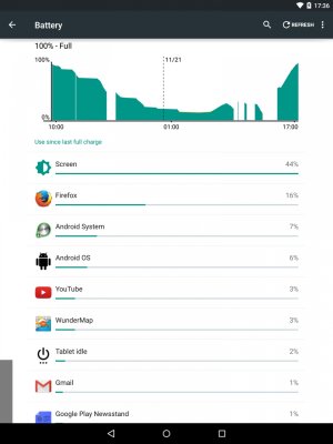

I've seen wonky battery usage. Yesterday I noticed the drain was precipitous whenever the screen was on. In fact, the charger couldn't charge faster than thge battery was draining.

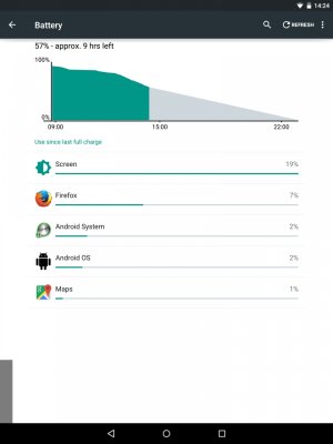

I know there hadn't been as severe a drain during the first two week so I wondered about the apps, especially all those apps that seem to auto update now in lollipop. I disabled the Google Docs suite entirely as well as Force Stopping a load of apps I only want running when I summon them.
The usage seems far more reasonable now, as shown in the before and after shown below.
before (there is a small increase in the morning, that was after attaching the charger - the rise soon turns into a drop as i begin using the tablet, the battery dropping even though it was still attached to the charger)
after
