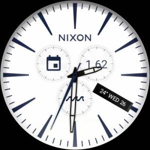

Also the Sentry watch face, any reason it would just show icons and not the actual data within the sub dial areas like the info is shown on Mission Watch face?
See agenda just shows calendar not a count down like it does (sometimes) on the Mission Watch face (having issues with this working consistently), as well as the surf conditions not showing any details for a quick reference. 😕
