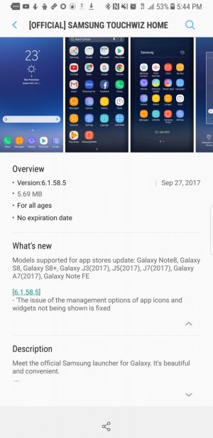

Is there a link to something official from Samsung about this?
I've recently updated and didn't pay much attention but TouchWiz was one of the updates. I've tried removing cache and data (Data was maybe not the best idea as I'm back to having a ton of nag stuff I can't delete anymore).
