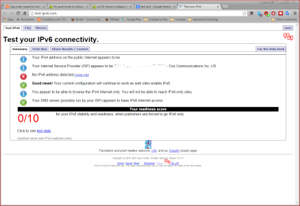

Had samething here downloaded app force gmail sync play store for 1.99 just pick sync time 1min to 8hrs .After reading all info that matty032 has posted on the other thread about ipv6 changed settings to 6to4 in wifi home router fixed all issues with sync !!!Many thanks to matty032 !!! I went to test ipv6 web page and did not pass all the tests went into cisco rounter and disabled ipv6 and selected to 6to4 tunnel settings went back to ipv6 web page and passed all test this time phone is fine on wifi now !!

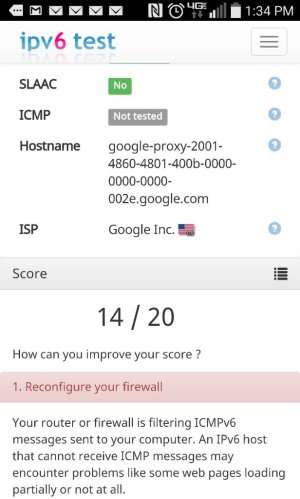

Not having 10 posts again is really annoying, just lost everything I typed because I forgot to remove that link. Long story short: downloaded Aquamail, K-9, Cloudmagic, created a new address just to spam myself with an address not on device. All day on Verizon, all evening on WiFi, seems to be "push when it feels like it" no matter the connection. At best I'd get all of gmail addresses pushed, OR all outlook, but never everything. Sometimes I wouldn't even get all, I'd have to refresh per inbox. And oddly, the only app getting email pushed is Gmail, but that's the right direction so that's a good thing (I think). I'm hardware savvy, but software issues trip me up, I can't figure out what's the problem.

The IPV6 test fails on either connection?

You have it correct, behaves exactly the same on either connection. And no, hadn't considered contacting Verizon because of that. I've only contacted them for select hardware issues and some signal problems in the past.
