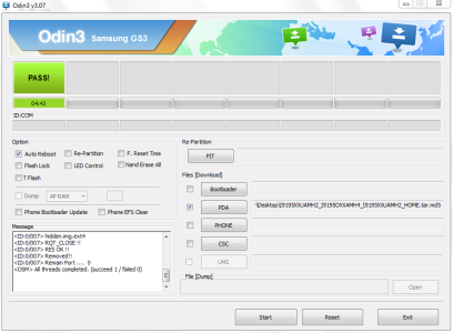

Get generic or your current ROM and flash it with Odin 3.0.7. It will do the hard reset when flashing. Have a look at the attachment what is ticked when flashing.
Never delete NAND or tick PIT partition.

exactly 100% correct instruction given that the odin version 3.07 is to use install recovery and format the phone from recovery mode.
My phone was there is no recovery mode and I could not install recovery mode using odin latest version. from this forum I read that to use odin 3.07 version and I try to install CWM recovery and it was success. then I format the phone from recovery mode. My actual problem was screen locked and I am not able to access my phone.(GT-I8190)
Thank you very much
