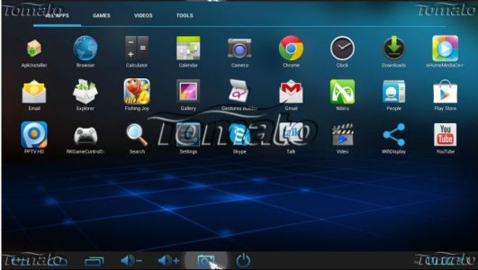

I´m trying to add a screenshot from one of the manufacturers of this box (Tomato), here you can see that the usual widget menu is missing.

Solved it!
I thought I had tried all possible combinations, but after a long press with the left mouse key on the home screen a menu came up for the Apex launcher, and there I finally had the widget menu.
Thanks for getting me on the right track (I'm still puzzled why the original customization has made it so hidden though.....)
