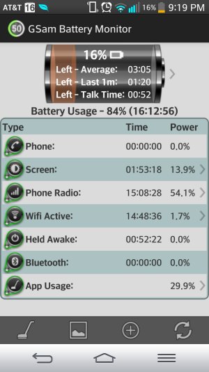

Picked up the AT&T version this weekend. So far, I have been getting pretty poor performance out of the battery which is weird because everyone else is raving about it. Here are my current battery stats.
Battery level: 18%
Usage on battery: 15 hrs
Expected time left: 2hrs 48min
Screen time on: 1hr 50min
I have used it moderately today surfing the web and playing a couple games. The screen hasn't even been on for two hours though and it is almost dead. The thing that is taking most of my batter power (45%) is cell standby. How can I reduce this? Maybe I'm being too critical, does this seem like the normal battery life you guys are experiencing with the g2?

If you are that high on cell standby, that is another issue. Do you have an battery trackers like GSam battery monitor? If not, download it. What kind of cell service do you usually have?

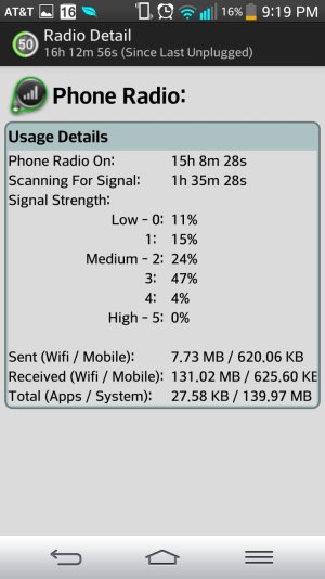

Yeah i think its weird that cell standby is that high too. I'm on a college campus and generally get pretty good service outside but sometimes it sucks inside buildings. Right now my phone has been without signal for 11% of the day, not sure if that is high. Will check out the GSam app.
The app will tell you how many bars you have, and what percent of the time. Today I has 5 bars-24%, 4-74%, 3-2%. Report back.
