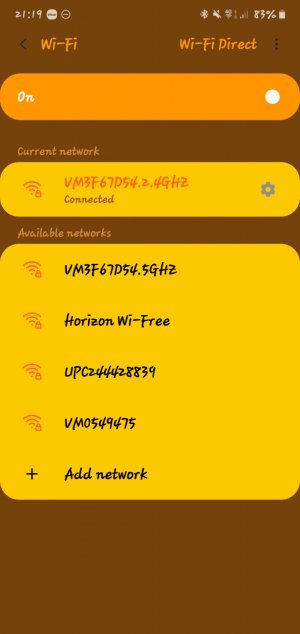

You can see here what you are looking for
