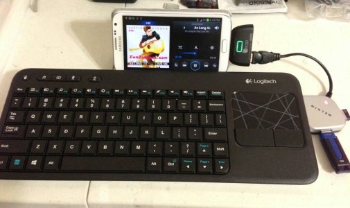

So after posting about buying one on amazon I decided to try to make my own. It looks like a butcher did it but it works lol. I took an old charging cable and I took apart a wall charge that stopped working a long time ago. I took out the female usb port from the wall charger. I cut off the end of the charging cable and soldered it to the female usb.
Then I took apart the casing on the micro usb side and realized it was encased with silcone so I was going to give up but decided to get this done. So I took the soldering iron and melted through till I hit the pin I wanted to solder. I soldered the wire then did the same on the other side and I was done.
Hooked up my thumb drive and it automatically connected.

1. Why did you have to remove the casing at the micro end.
2. How did you map the contacts in each and know which to connect to the female USB connector?

Ok on the micro usb side. There is 5 pins
Pin layout goes as follows:
1.power
2.data-
3.data+
4.Not connected
5.Ground
In order for the phone to get into the plug and play mode. Pin 4 needs to be grounded so I needed to solder a wire from pin 5 to pin 4. I used this guide for reference
http://androidhardwares.com/how-tos/how-to-make-your-own-usb-otg/
For the female usb connector I ripped out of the charger I used this wiki Page to figure out the layout
http://www.allpinouts.org/index.php/USB_-_Universal_Serial_Bus
The usb wire colors are universal standard so that was easy.
