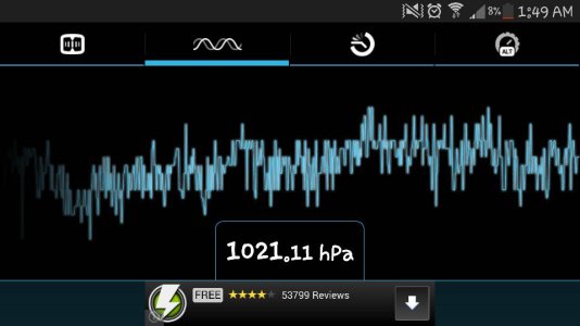

Pictures paint a thousand words. As can be seen above I have been getting unusual readings from the barometer sensor on my new note 3. I have run the self test on the barometer sensor and it passed. This is not surprising since the odd readings are intermittent. I am obviously using the app SyPressure, but have also had spurious readings from other barometer capturing apps as well. At this stage I have no idea whether this is a hardware or software issue or if the sensor is still calibrating. This all worked fine on my Note 2. Also these reading were when the phone was just sitting on the table in one place, not when the phone was on the move in any way.
I wanted to ask if there are any other Note 3 barometer users out there who have had anything like this or is it just me, i.e a hardware fault on my device?
Obviously I am also interested if anyone else is using SyPressure or another app that stores the barometer readings on their note and not having a problem. This will be evidence that it is a hardware issue just with my Note 3.
Thanks
Device: Note 3 - GT-N9005 brought sim-free unlocked.

Thanks for the response, but you are looking at the measurement at just one time. If you see from the screens I pasted I was using the historic function, that showed I was getting a bad reading only once in a while. The rest of the time the readings were normal.
Please see if you get any funny readings over a 24 or 48 hour period

Is this taken as a one time reading or when you have sypressure recording the readings over a 24 or 48 hour period? I like sypressure as it tries to make weather forecasts based on the pressures it is seeing, but each to their own. I did try weather signal and also got a few funny readings over 24 to 48 hour period.
What I mean be a funny reading is one that was below 900 or above 1100 millibars, which should never happen especially if the phone is sitting in the same place the whole time....
