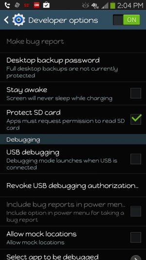

I've read plenty of horror stories with Sandisk cards in Samsung devices, particularly, the Ultra line of cards. This is the first post I've seen of the Note 3 doing this though. However, I do see the option you've noted in the developer settings on my Note 3:
Thanks for the reply. How'd you get to the Developer Options screen from the home screen. I've looked through all my options and can't find it. I'm an an ATT Note 3.
No problem. Go to Settings, tap the General tab, scroll down to About Device, go to the bottom and tap on Build Number 7 times. ...this will turn on Developer options.
Let us know if this enables you to do what you need to.
