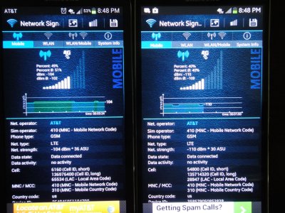

Ok well I've conducted a simple test and here it is. Seems the Note 3's radio is substantially less sensitive than that of the Note 2's The following image shows both devices running KAIBITS Network Signal Info app. Both were out of their external cases and the Wi-Fi was turned off. As you can see, the Note 3's receive signal was measured at -110 dBm, while the Note 2 measured in at -104 dBm. That's a 6 dBm difference!! Now let me shed some light for those with little or no RF knowledge. +3dBm doubles your signal, while -3dBm cuts it in half!! So in essence if I take the Note 2's signal and cut it in half TWICE, that's what the Note 3 is receiving!!! DSC01388.jpg

Yes but that's relevant to YOUR carrier and YOUR signal strength where you are. That's does not mean that's law. Everywhere I have been I have had much better signal strength with my 3 then I have had with my 2.

Can you do a similar test with wifi?

Unfortunately not. I took it into AT&T this morning and we were able to replicate my results using a side-by-side with their Note 3 demo using both the KAIBITS Network Signal Info app and the native "Status" info. They ended up replacing my Note 3, which I tested again against their Note 3 and both displayed very similar readings. With that being said, they're probably are a few "early adopter" Note 3's out there with subpar radios. I pre-ordered that one on the day AT&T started taking orders, so its probably fair to assume it came from an very early production batch.
