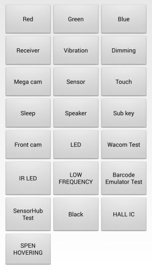

When I do *#0*# and bring up all the test modes, when you click on Sensor, its brings up the scales to see whats working and whats not.
When you hover you finger over the sensor the screen should go Green. to prove that it works.. Mine does not.

Here is what comes up when you pres *#0*#

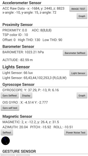

And heres what comes up once you press Sensor.
When you place your fingers over the sensor, the figure are supposed to change and the screen goes Green... mine dont.
I wonder if the sensor has crapped out or its a software problem? Any Note 4 sensor specialists out there or repair people that confirm its a common thing????
