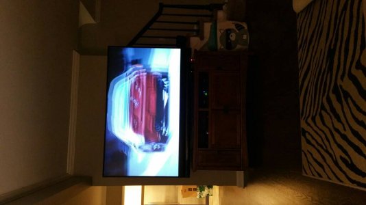

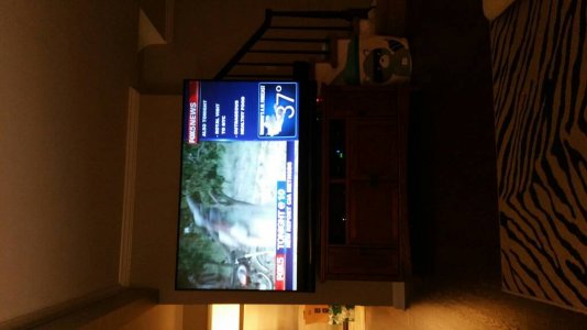

Ok good. It's not just my phone. I'm with the op. I love this phone but it takes bad pics when anything is in motion even slightly. It's amazing how many great writeups this phone has for its camera. In my opiniom, it has got nothing camera wise on my old iPhone 5s or even my 4s for that matter.
Also I thought this phone had image stabilization? If I take a pic of a still object and my hand isn't 100% still the pic comes out blurry.
Here's an example. Took a pic of my TV.
Guy walking across is blurry.
Also a car shot.

You can try going into settings, and changing the ISO from Auto to 400 or 800. Depending on the metering mode you use, if there is a bright light source (like a TV screen) it can fool the auto ISO into thinking it's a brighter scene, but the shutter speed will be slow to try and capture the dark parts of the scene. This would result in blurred movement. Indoor pics can be tough even with high-cost camera gear, especially when it is pretty dark, has areas of high brightness and much darker areas in the same scene, etc.
Thanks georgecollins1. I tried those tricks, no luck. If something is completely stationary, it's fine. Or if it's bright light, it's fine. But get a moving child inside, and no way. :(
The only way to eliminate motion with my 2 year old daughter in low light situations is to force the flash on. That works always. Like you said, there are no issues in bright light situations. When the flash is on, the shutter speed is significantly faster and there are no motion issues. Try this. It worked for me
Not sure if people realize this but essentially what is being described is the exposure programming's propensity to use shutter speeds that are too low to capture stop action in low light situations. The images in NVNJ's post in post 9 of this thread show no movement of the TV itself but obvious movement in the images the TV produces. This indicates the shutter speed was high enough to be stable for still shots (the TV isn't moving) but not high enough for stop action.
As for the iPhone vs this camera its likely that if the iPhone is producing better action shot results in low light that its exposure metering is pushing higher shutter speeds which result in that stop action.
Personally, I just don't reach for a cell phone camera in low light indoor shots for anything but stills/portraits. If I know I'm going to photograph action indoors I'll bring or reach for my DSLR, set the ISO to a high enough setting to give me a shutter speed of over 1/120 or higher and I'm good (unless its sports in a gym at which point I'll push to much higher shutter speeds).
Not sure what the solution is for the Note 4. I poked around in a few camera apps and haven't found anything yet to gain full control over shutter speed which really is what is required to solve the issue people in this thread are having.
