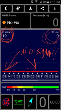

I tried TopNTP and that made no difference. Here is an image of whats going on when I run GPS Test:
The NV rebuild is only available (at least on the AT&T version) when you pull the AT&T SIM. But root works, too. :)
If you've done the NV rebuild then the only thing I can think of is a hardware problem.
It doesn't seem logical that there would be significant hardware differences between the two major GSM models - having said that the AT&T one was the one that had more reported GPS problems than all the others so there could be something wonky going on there.
Well since the motherboard is a T mobile one, I would hope it wouldn't have any issues.
Should I go so far as to try putting the T mobile daughterboard with the usb on it, into the ATT shell? Instead of the (apparently identical) ATT daughterboard?
