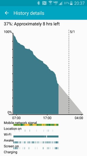

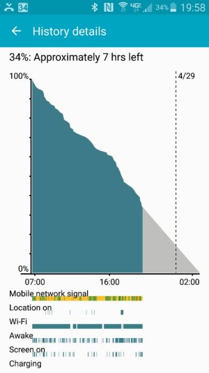

Under battery stats it doesn't show Location being accessed much. Does that bar show GPS access only?
I think it has to be showing less than what is being used. I have one app that access every hour at minimum, every two minutes during certain weather. It isn't showing all my access at all on thst graph.

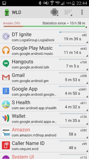

Here is what wakelock detector gave me last night. Today I tried disabling Google App and I archived all my hangout chats (hangouts does my sms too) because I read somewhere that can cause it to use a lot of battery.
Unfortunately it didn't seem to help as my wakelocks are still plentiful. I'll try to check WLD later to see what it was this time. I did notice the actual location line showed up more now.
I suggest that you disable DT Ignite right NOW. It may or may not be the source of your issue, but it is bloatware whose purpose is to load more bloatware. Get rid of it.
I disabled DT Ignite so we will see how tomorrow goes. I noticed today my phone had fewer wakes from Hangouts by a lot, but Google Wallet jumped up to over 900x and Vzw location services were pinged exactly 199x - what's interesting is that Samsung Push services were also exactly 199x.
Didn't work. I then yesterday tried a factory reset AND didn't reinstall everything and the wake locks are there. I'm thinking it's a lollipop thing?
