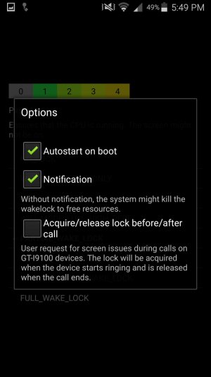

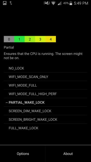

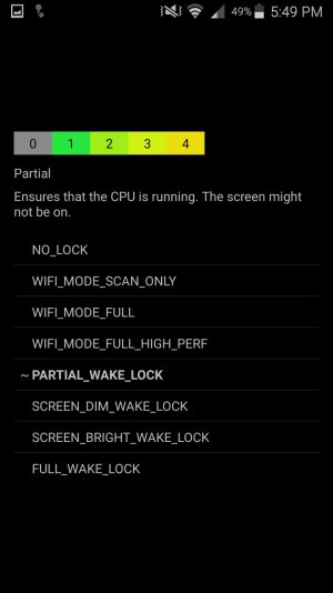

Install WAKE LOCK - POWER MANAGER by Darken. It is available on the Google Play site. It will get your Note 4 back to functioning like it should. This issue is NOT caused by any of the following:
Apps
Battery
SD card
and will return after a hard or soft reset.
This is an OS UPDATE CONFLICT. The Note 4 is the last Note with a removable battery. Another solution is to have the battery charging cable disconnected. You will need to swap out batteries whenever necessary.
