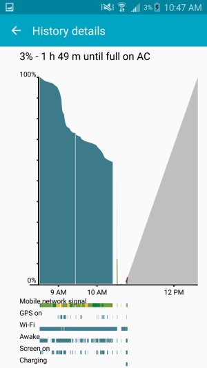

I have a Galaxy note 4 and its been like a year I have had it. The battery now goes from a random percentage to zero. Does anyone know how to fix this?
Most likely your battery is going bad. Seek a replacement, either OEM or aftermarket. Personally I like the ones from Anker but there are other options out there I'm sure.
I was having the same issue for a while. The only thing that fixed it was getting a new battery. I got an anker replacement battery. Actually 2 of them plus a battery charger for $28.00 on amazon.
The battery has done what rechargeable batteries do over time; go bad. Get a new battery.

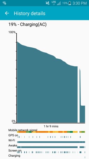

I gave it a shot and I've got a very noticeable improvement in my battery life. With your battery going from 50% down to 0, I'm sure that you'll need to buy a new battery sooner than later, but maybe this would work as a short term fix and give you some improvement while you wait for a new battery to be delivered.
5 months ago, my battery would drop from about 17% to 0.
Or, the battery status would say 22% (visible when charging), but I couldn't turn my phone on.
A few weeks ago, it got worse by saying the battery was at 27%, but still wouldn't stay on.
Replacing the battery helped, now it works well.
