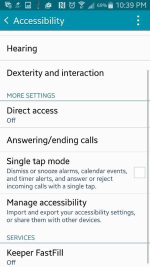

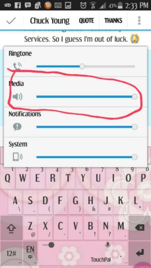

Ok... It's very hard to explain by typing.... See if u guys can follow me... The calculator and S Voice works kinda like against each other... In the settings under accessibility scroll down to services turn those things off S Voice will work... Turn them on the calculator talks back to you S Voice won't!!! now for me all I have under services is Go locker so it was easy to figure out what was the issue... If u have more than 1 app under accessibility/services you have to figure out which is the culprit... When I turn go locker on the calculator talks back to me... To temp disable the calculator voice u can turn media sound down... To totally disable it you go under accessibility/service turn off whatever services is on... Can't make it any clearer.... Don't be afraid to play around with the device just remember your steps... No one helped me... I just played around with the settings until I figured it out!!!
It's definitely an issue with auto fill.
I turned last pass off in accessibility & the calculator stopped taking to me.

it's *anything* in accessibility that's turned on that's causing it. i don't have fast fill but i had led blinker pro turned on and as soon as i turned it off, the calculator stopped talking. it sucks though, i hope there's a fix for this issue soon.

I somehow didn't see that I had Roboform in there. Turned it off and all is well.
