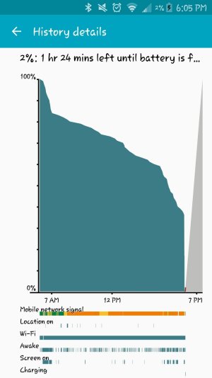

My Sprint Note 4 (running 5.1.1) has been working without issue for the past year, but a strange power/battery/something issue happened yesterday and today.
Both days, around the same time (between 5:00-6:00pm) my phone has decided that it no longer has a charge and shuts off. Yesterday, the phone went from roughly 35% > 10%, which alerted me of low charge > 0% and shutting off within around 30 seconds. When I plugged in the device, it wasn't charging and didn't indicate that it was plugged in. I took the battery out > put it back in > plugged it in and it started charging, but registered that it had a 34% charge.
Today, when I got home I checked my emails, which showed a charge of around 37%. Once I opened the first email (in the MS Outlook app), the phone started it's shut down process. Once I powered it back on, it showed 0% charge. I plugged it in and it started charging normal (from 0% this time), no need to remove the battery.
I haven't installed any new apps, and keep the ones that I have installed updated. I'm not sure if it's the battery itself that's failing or another issue. I usually let the phone drain down in to the 10%-20% range before plugging it in to charge, which has never been a problem before.
Attached is the screenshot from the battery meter settings. Any ideas / thoughts / suggestions would be greatly appreciated!Screenshot_2015-11-18-18-05-23.jpg
My gutt reaction is in cases where there is rapid (instantaneous) power drops like this its either bad connections for the battery or faulty battery. I suspect faulty battery but verify the terminals on the battery and the contacts on the phone are clean just to be sure. I'd document a few instances of this with screen shots and contact Samsung to see about possible battery replacement under warranty.
FYI, on Amazon one can get a couple of spares made by Anker for $25 with a charger to boot.

Update - I had one day (I forget which) where the battery drained down normally (which strangely was closer to 8pm when it hit the normal battery level where it dies), but all others had the same issue. Timing has been consistent (between 5-6pm, excluding the day mentioned) and yesterday the phone just shut off in the middle of streaming music with the SiriusXM app to my bluetooth speaker at 5:59 with the screen being off for probably 15 minutes prior. I plugged in the device, which registered 0% for a few minutes, then jumped up to 48%, which seems correct as it had close to 50% when I put the music on.
So we have AT&T, Verizon and Sprint customers experiencing the same issue, so if it's software related it's not carrier specific. I can't speak for other carriers, but Sprint pushed out a 5.1.1 update (version N910PVPU4COJ6 shows on my phone) earlier this month and I never experienced the issue before that.
