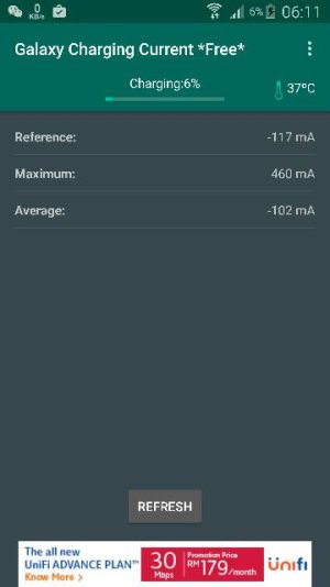

same.goes to me and when i check the charging current it shows as below..its actually discharging instead of charging
