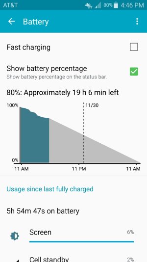

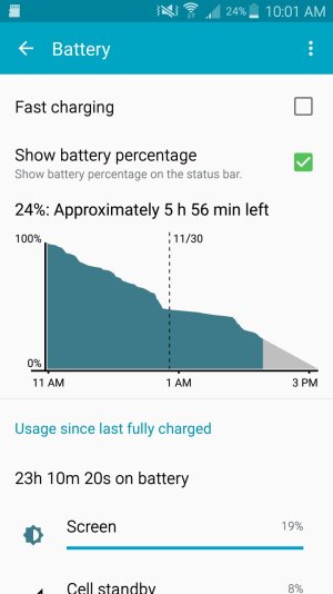

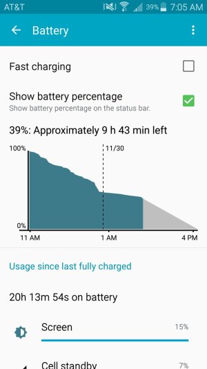

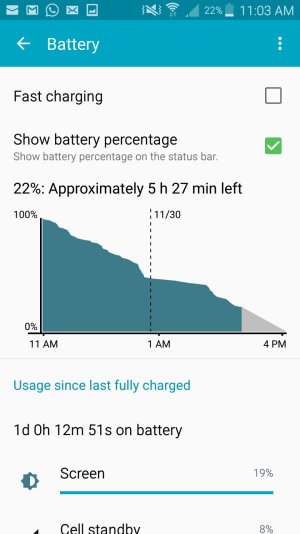

These are the screen shots of the phone on a single full charge from 24 hours ago. These are results from a week after having started using the new DURACELL battery. Still working like a new phone. I'm not trying to advertise for the battery, but no less than trying to help the Note 4 owners just like me.
Battery % remaining after 24 hours ≈ 20%
