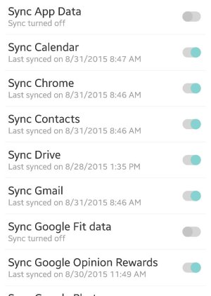

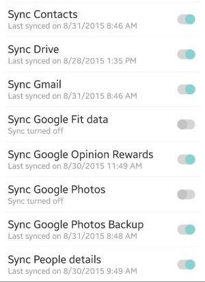

I just remembered to turn off all the unnecessary accounts syncing (Google syncs so much), and I'm wondering does this improve battery life, particularly in the background?

Also Google syncs a lot of stuff. I don't use Google fit, so in the sync settings, I uncheck that. I don't sync apps to Google. I sync my calendar, my contacts, my mail, my internet, etc. This is what I sync on my main Google. I have 4 total Google accounts on my phone. This "people" at the end, is kind of new.. Not sure what it is, haven't researched it, but I'm syncing it for now until I know what it is. I have a lot of notes and info I add to contacts and I'm not sure I'd that is what the "people" is or not. I kinda think it isn't, but until I know for sure, it is being synced. It is just one thing.
