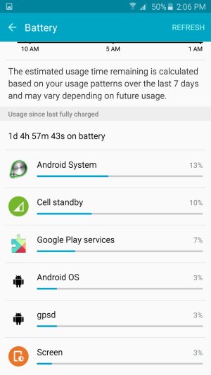

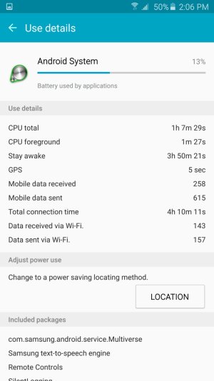

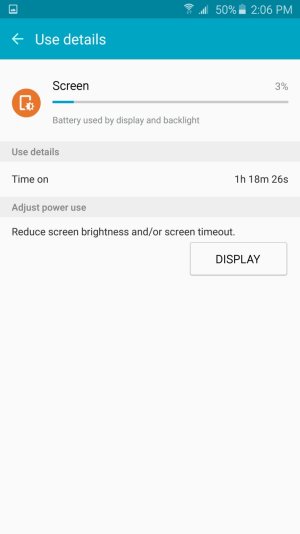

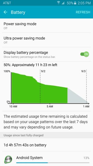

Screenshot_2015-09-02-14-06-01.jpgScreenshot_2015-09-02-14-06-09.jpgScreenshot_2015-09-02-14-06-17.jpgScreenshot_2015-09-02-14-06-28.jpg
I wanted to test standby time where I have good coverage. I don't use fb, twitter, etc. I have 2 google accounts with majority syncing. All the google now stuff is on. I used the phone for about 30 mins, a few messages (<20), and the rest of the SOT can be attributed to internet and youtube. I did restart my phone late last night because I noticed android system was keeping my phone awake for no reason (you can see the change in slope around 2 am mark). Hopefully android M will fix some of these wake issues. I am the opposite of a power user so I can't speak for everyone here, but I think that most people's problem on this thread is bad reception.

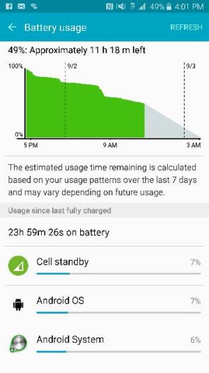

Again. No idea how people are getting this epic battery life without shutting down tons of features. Mine is attached and I have Approx 3 hours left.
It's OK but not the unreal stuff I've seen from others.
Could be the google app has a ton of wakelocks. Try turning it off.

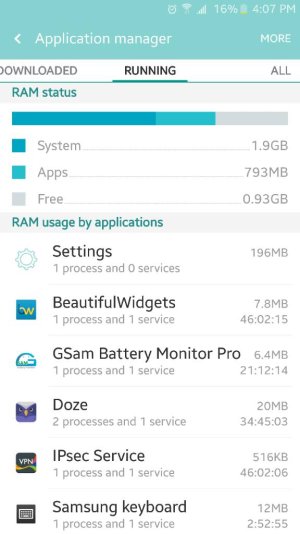

Facebook messenger is going to use a lot of resources and if you use it, it will always run on the background.
