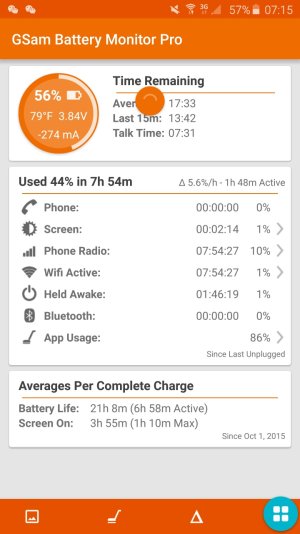

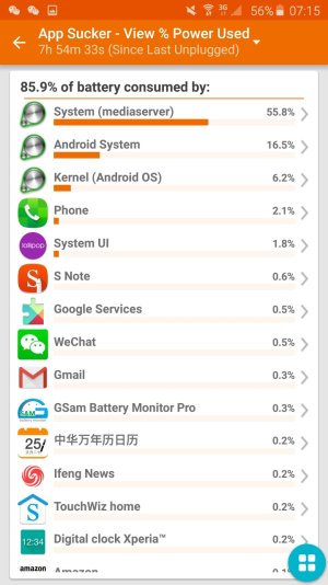

Can anybody explain the "mediaserver" process? It is draining my battery to death!
I fully charged my Note5 last night and leave it there (muted, wifi on). 8 hours later, the battery drop from 100% to 56%!! And 55.8% is consumed by the "mediaserver" process!
I have no audio files, no images on the phone.
At first I thought it was the poor signal at home; but when I put it in somewhere else with excellent signal, same results...
I did some research on the "mediaserver" process and it sames that the solution is only for rooted devices or old phones with SD card.
Any suggestions will be appreciated! :)

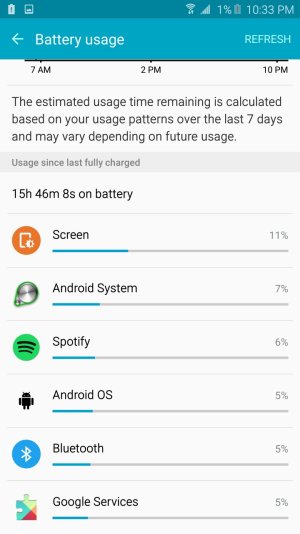

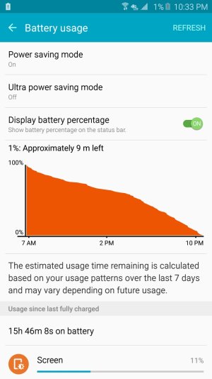

Battery life is still terrible on my device. Better with bluetooth disabled but still wont last much past 10pm either way.

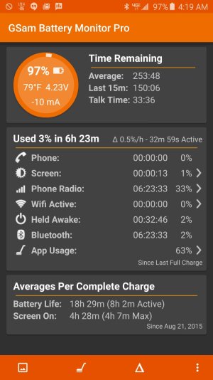

Hmm I'm on AT&T as well here's some screen shots of my battery haven't used Hardcore but have made texting and lots of gplus and Tapatalk browsing, do you get anything like this.
Running On Samsung Galaxy Note 5 N920A
//images.tapatalk-cdn.com/15/10/02/b2b4b2d58d4bdea33863785044b6d437.jpg
//images.tapatalk-cdn.com/15/10/02/2dff79a2e04461d74675ea42f913f1eb.jpg
Nope, mine starts at the top and then drops all the way to about 8 or 9pm That night. Past few days I can't get over 10 hours. I work most of the time remote from home and so I answer texts, emails, do light browsing. I made two phone calls today. Normally, I listen to Spotify all day, but I have my Surface PRO 3 for listening to it.
