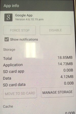

I came across a simple solution to this. On your home screen you should see the "Google" icon. Drag it to the info box on the top of the screen. There you will see the option to force it to stop. Select that. Then select disable which will bring it to the original factory settings. Then force that to stop. You will now have the option to select a different shell. Do not select Google Now. After that in the upper right corner you will be able to turn off ultra power savings.
After dragging it to the info box, disable was the only clickable option.
Even after clicking it, the disable option remained disabled.
Any thoughts?
