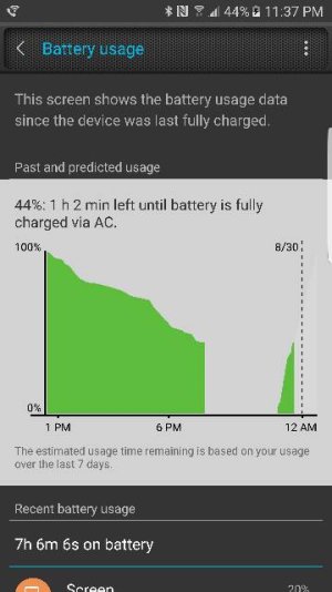

Went from around 40% to completely dead. Couldn't even turn it back on. Was listening to Pandora while phone was in my pocket and it shut off.
Weird thing is, when I looked at the battery chart you could see the charge drop to around 40% then the chart drops off.
This is the first time this has happened.

Here is the graph

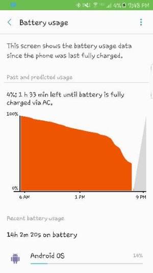

*sigh* Well after singing the praises of this phone and the battery it finally happened. I noticed my battery was dying extremely fast. Like 1 percent ever 30 sec. Thought it was weird. Then all of a sudden at 25 percent it turned off. So frustrating. Same thing happened with my note 4 and my note 5 had battery issues too. I'll be honest I am a Samsung fan but this is really starting to tick me off. And I hate to say this but I told myself I wasn't going to use my wireless charger because that is when my note 5 started having battery issues. I used it for 3 nights and now this. Coincidence? Maybe. But all I can say is it seems like whenever I use them something happens to my battery.

The pictures in posts 7 and 11 are signatures - they might as well have "dendrite" written all over them, because that's what you're seeing. A dendrite (chemically-caused short) growing in the battery, shorting it out. The short burns out (it's only a tiny crystal) and the voltage is around where it was before the short (or even a little higher).
The auto industry is spending billions (that's a "b", not an "m")trying to find out exactly why lithiums do this, so they can make electric cars with lithiums - and no $5,000 "we may have to pay it" tag on the car. NiCds work (hybrid cars use them), but lithiums would work a lot better - except for the dendrite problem. (Imagine accelerating to avoid a fatal accident just as your battery shorts. Wrongful death suits from causes that were known years ago tend to treat money by the long ton, not by the dollar. There's no cost/benefit ratio, because the auto maker would lose. Once they get that problem solved, we'll see dendrite-proof batteries in phones - probably for more money even if it costs 3 cents to fix the problem.)
