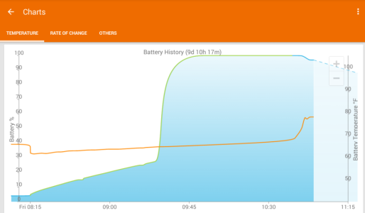

Here is a snapshot of my battery charge time via GSam Battery Monitor app. Here is the info from the chart.
Battery charge was at about 4% at 8.15am when I plugged the battery in for charge. Around 9.20am the charge was about 28% (~10% every 27 minutes...which is about 4.5 hrs for full charge, inline with what various tech publications claim for Note 8.0). Then the interesting thing occurs. The battery charge then instantaneously shoots up from 28% to 100% (fully charge). Does this clearly indicate there is something wrong with the battery? I am only getting 2 hours of full video play time which is significantly less than 8 hours claim by the same tech websites referenced above. The 8 hours may be with airplane mode, but i don't have many apps that are really pulling much data in the background. So the diff in the video play time with airplane mode on and off shouldn't be that different.

Isn't removing the battery the same as letting it drain completely? I let it drain completely and kept it that way for several hours. It improved from 1 hour of video play time to about 2 hrs of video play time. This is still significantly below what it should be. I am going to send in for the service. Thx

It probably reset the battery charge information the tablet was storing and it now correctly knows when the battery is and isn't low.
