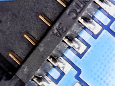

From my experiences of various Samsung tablets, they all have the same common problem: cracked battery connector. However, the hairline cracks are not easily seen, even with microscope at 10X, a close up picture like this, you still don't see it
However, I normal use a screw driver to gently push or lift it to test if it's moving under a microscope . The two I tested, one is moving, another is lift off easily. After re solder the battery connector, the two tablets are working fine . You should bring your tablet to a repair shop, disconnect the battery cable,
ask them to do a re work, it should take no more than 5 to 10 minutes. The rework can be done without removing the mainboard, you only need to take off the back cover and disconnect the battery.
Trust me, I bought not one , but dozens of Samsung tablets with similar problem like yours because I know exactly where the problem comes from.

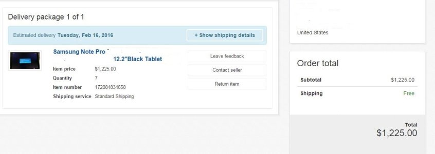

Look what I bought , I could take 7 of them with confidence as I know exactly what is causing problem
