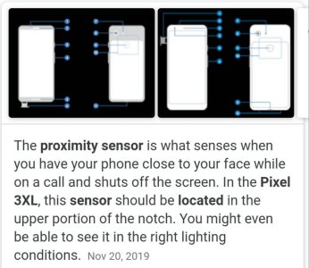

Also make sure no case or screen protector causing issues with proximity sensor
I don't have a screen protector but I do have a very thin Spigen case. Where is the proximity sensor in question?
Never mind. i see it's at the top by speaker. so to test i made a call and would bring my finger close to at and screen goes black. move finger away and screen lights up. I can do this back and forth multiple times and the screen reacts accordingly.
Ok so seems to be working

Start a telephone call, preferably to someone you know that you won't have to waste time actually speaking to. Call your wife's phone, or maybe a time service like this one https://www.aarp.org/work/on-the-jo...rvatory's time,by the U.S. Naval Observatory.
Anyway, once the phone initiates dialing, sit it down on the table and hover your finger over the proximity sensor (near the speaker) to determine it's range and, in particular, it's side-to-side sensitivity.
I find that on my 4XL I can easily drag down the notification bar from near the left side of the screen without triggering the proximity sensor. This approximates the motion I first suggested, your ear tip contacting the edge of the screen before the proximity sensor is close enough to be triggered.
