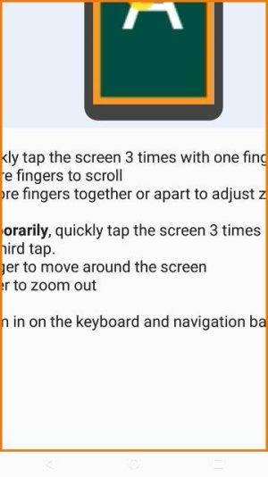

On my Nexus 6P running Nougat I have the following option in the Accessibility section:
Magnification gesture. Tap 3 times on the screen and it zooms. You can then drag with 2 fingers and pinch/spread 2 fingers to zoom in/out. You can also tap 3 times and hold to zoom in and pan with only one finger.
That gesture DOES work with the notification shade. I can add screenshots of the option screen later if you want.

The AC app seems to be a little wonky when it comes to posting pics or viewing them as attachments. I only see one pic as well, and it's zoomed in -- was that an example of the magnification feature?
Yes, it was. I'll see if I can get the others uploaded tonight, including one of the zoomed notification shade.
