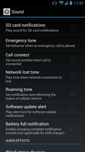

Some 3rd party apps can mess with notifications. Try running Air push detector. It checks for apps using the most common notification based adds.
Also, you could be getting notified when you gain or lose wifi or data signal... or possibly when your phone reaches full charge or a predetermined low charge percentage. I'd go thru and check your settings for notification settings like that.
Any one of these might get you seemingly random notification sounds.
Sent from my DROID RAZR using Android Central Forums
Are you by chance using Yahoo? I ran across a thread somewhere else & I think that ended up being the issue.
Sent from my Unrooted Droid Razr Maxx Using Tapatalk
My wife's phone started this about a week ago. We just got 4G in this area and it seems to be a bit spotty and every time it dings, it's either toggling from 3g to 4g or back. Cannot figure a way to turn it off, even though all of the settings as shown in the previous post are set correctly. Is there a way to set the phone manually to 3g?
You made sure none of these were checked?
