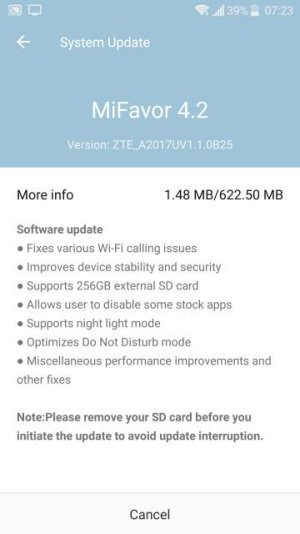

It's only the SD card installed causing the problem. It's a issue ZTE didn't catch in testing. May be fixed soon but anyway removing the SD card and trying again should work.
Holy smokes. That worked. I took out the SD card. After the reboot it wouldn't recognize that there was an update waiting. I rebooted a second time and then it did. Thank you thank you thank you.
